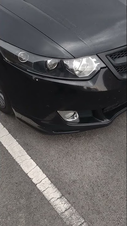

No I chose to butcher the existing lights and painted the orange reflector black using aluminium tape to stop light bleed and added a round lense like so:
Remove the screws on the back, and take out the bulbs. Heat the light up I used a heat gun, an oven is probably better, or a box with a hole in it for a heat gun as a makeshift oven.
Then just use several flat head screwdrivers to separate the lense from the main body of the light. Careful at the ends as there very tight and I broke the indicate lense peice behind the orange lense when separated. I just glued it back together. Painted the orange reflector black and used aluminium foil tape on the back to stop any light coming through. I found the chrome lens after searching aliexpress;
Mounted them to the front of the now black indicator lenses. Also put in some sequential indicator and drl strips. Then I also fitted new lenses as the first time I did these I wasn't happy after reusing the original lense. New lenses where on a lie press too. Just reheat to seal back up I used some more butyl that I got from a guy doing works new roof.
Still looking good and working great even now my brother in law has the car after I replaced it.
