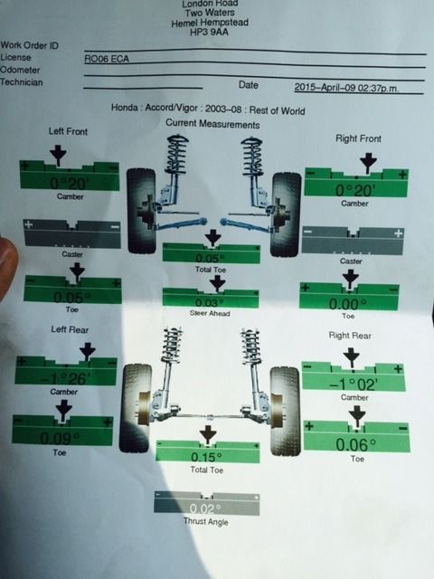

Last week i changed all 4 tyres of my car to GY Asymt 2 and went for 4 wheel hunter alignment and this is what before alignment came out. The guys at Tyre pros were really good and didn't charge me anything as it was already in align.
Before change of tyres i had a little drift towards right while driving on motorway towards right, meaning to keep steering slightly in antilock by 2 degree will keep me straight. When wet to Honda they said i had camber issue at rear which also according to them caused inner end tyre wear on rear.
I am confused what is going on, Honda is saying issue with rear camber, and tracking check says nothing is wrong. Can you critically ****yse this diagram and let me know if there is any clues to my problem.
Many Thanks

The alignment looks good and all within spec.
Have you been carrying heavy loads in the boot.
This can cause neg camber when loaded and wear the inside of your tyres.
Just to check try another place to get the alignment checked and compare results.

How long have you had the car as going by your alignment it perfect.
Maybe the previous owner carried heavy loads or towed causing wear on the tyres.
