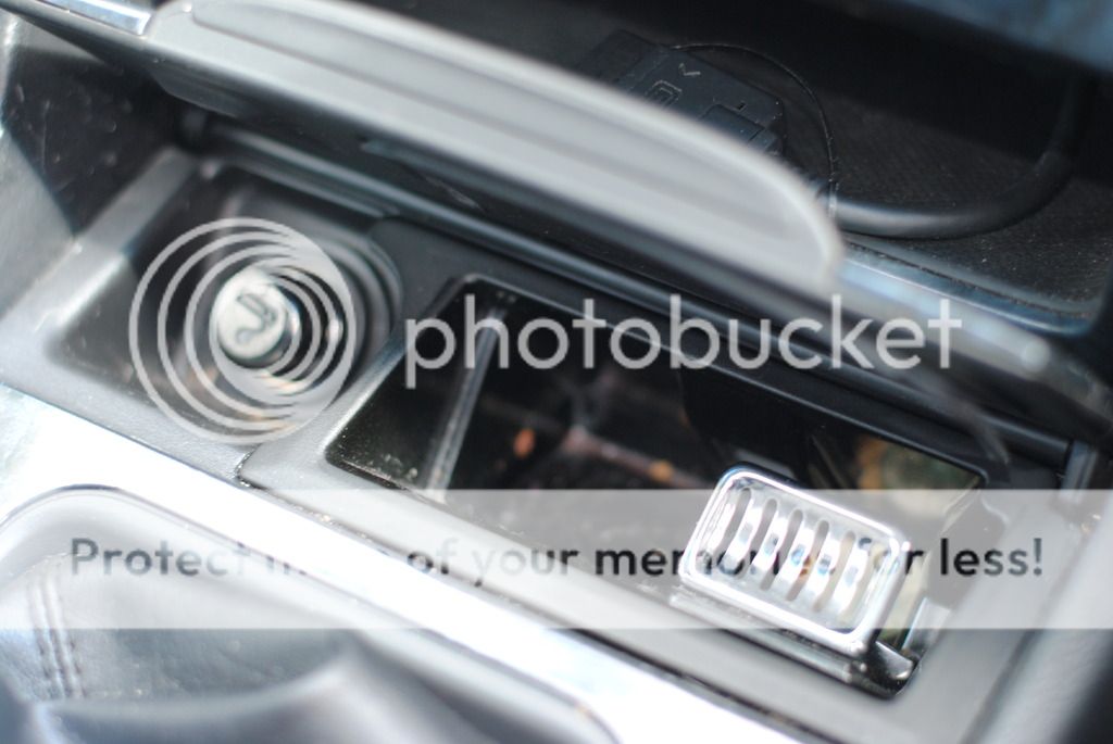

Flip open the ashtray cover and pull the ashtray out.
Revealed should be two crosshead screws. Undo these and don't drop them when they come out.
Lift up the front of the gear stick surround - it's held in by clips, so just pull it.
Once the gear stick surround is up this will release the cigarette lighter and ***ociated mounts so the whole lot can be pulled out.

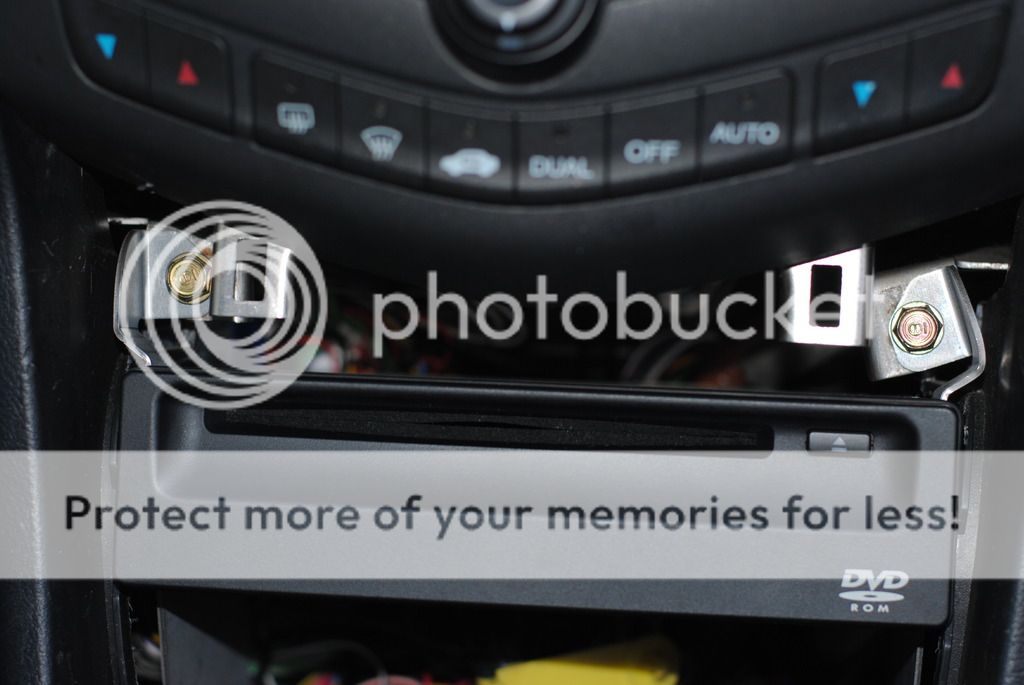

Look closely at this photo - see the crosshead screws at the extreme left and right? Undo those. Don't drop 'em. They're holding in the facia around the DVD player.
Now pull on the facia - it's held in by clips and will just come out.
