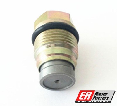

Could actually be your fuel pressure relief valve then
Would a regulator fail when cold then be fine once the fuel has reached a certain temperature ?
Rotting fuel in the tank / fuel lines ?
It can yes, they basically have a spring inside them which holds tension to a point to allow fuel pressure to relieve if it exceeds the target pressure. If the spring is knackered it can do weird stuff like this, opening up and jamming at the wrong time. They’re so cheap now it’s worth changing to eliminate it.
