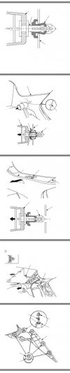

  • The upper clip in the rear pillar trim (A) consists of a resin grommet (B) and a metal pin (C). The grommet expanded with the pin secures it to the body panel (D). The grommet must be replaced with a new one when the trim is reinstalled.
  1. Remove these items:
  1. Fold the seat-back forward.
  1. Hit the upper clip in the rear pillar trim (A) with a rubber mallet. The clip is located under the point where the triangle mark (B) on the edge of the trim indicates. Hitting the clip slides the projections (C) on the pin (D) and pushes it into the grommet (E) and against the body (F).
    NOTE: The grommet must be replaced with a new one when the rear pillar trim is reinstalled.
  1. Pull the top of the rear pillar trim (A) back by hand to remove the upper clip (B) from the body (C).
  1. Pull the rear pillar trim (A) by hand to detach the clips and to release the hook (B), then pull the trim out from the rear shelf (C).
  1. If the side curtain airbag has been deployed, replace the rear pillar trim with a new one.
  1. If the side curtain airbag has not been deployed, check the rear pillar trim (A) and note the following:

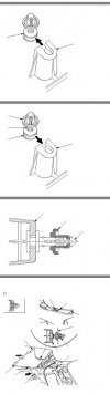

  1. If the new rear pillar trim (A) will be installed, before installing the trim, temporarily remove a new upper clip (B).
  1. Check the overlap between the headliner and the rear pillar trim, and if necessary, adjust it.
  1. Carefully reinstall a new upper clip (A) to the rear pillar trim (B). Be sure that the grommet (C) is nearest to the top of the pin (D) as shown.
  1. If the old rear pillar trim (A) will be reinstalled, install the new grommet (B) to the pin (C). Do not push the grommet too hard. Be sure that the grommet is nearest to the top of the pin as shown.
  1. Reinstall the rear pillar trim (A).
    -1.​
    Set the bottom hook (B) and the projections (C) of the trim to the rear shelf (D).​
    -2.​
    Place the trim over the rear pillar (E), and fit its upper clip (F) and the lower clips into the holes (G) in the rear pillar, then lightly push the trim into place.
    NOTE:​
    • Make sure the side curtain airbag isn't tucked down under the clips and the ribs.
    • Apply pressure to the areas of the trim on the upper clip until these clip fittings are felt. If you push too hard, the clip will be damaged, and it will not hold the trim properly.
    • Make sure the upper clip portions of the trim don't come off the body by tugging on the trim.
