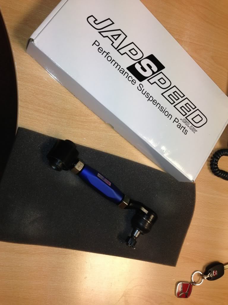

Have a Hunter Alignment done.
Depending on results of Alignment Purchase Camber Correction Kit parts For Front / Back or both
