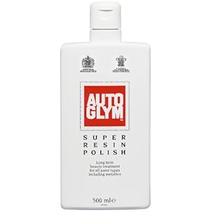

Autoglym Super Resin Polish
Collinite 845 Wax
check the members ride page link in sig below to see the results that combo does on a 18 year old paint ;)

Hi I've ordered collinite 845 heavy duty insulator wax and autoglym super resin polish and meguiars clay kit .
Please forgive my ignorance but after i do the clay part what order do I apply the other products IE which is next the collinite 845 or the autoglym :wub:
Thanks .
Personally not used collinite 845 but looking at the product spec and the product spec of the AG super resin polish, I would do it in the following order.
Wash the car ( using a wash mitt and preferably two buckets one to get clean water from and one to rinse the wash mitt in, basically called the two bucket method)
Preferably dry the car off with a drying towel, rather than a leather.
Clay the car, it is time consuming, just remember it is well worth it, then wash it again that will get rid of any clay residue left over from the lubricant ( less if you use a microfibre cloth to wipe as you go.)
Then use the AG super resin polish, this has a paint cleanser, polish and a sealant all in one so you should also get a good glimpse of what sort of finish your going to get.
Finally finish with the collinite 845, which by the write up should give a good finish and hard protective coat, then stand back with a nice drink and admire your handy work, then once it has been rained upon, admire again how it just beads away ;)
Collinite 845 Wax
Marcus thats a lovely car ,well done its blindingly gleaming ,if I get that quality i,m gonna be well happy . I am sticking to your combo , end off .
