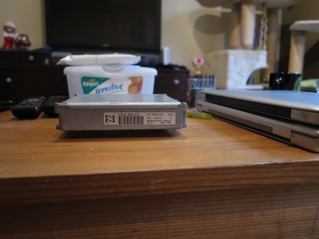

Well I couldn't sleep, did a couple of letters, then the Romney-Obama foreign-policy debate started on BBC News-24 at 2am our time. tbh it was tedious, Romney had the same rhetoric as Bush jnr but could talk eloqently, while Obama had a less aggressive rhetoric but stumbled a bit like Bush jnr.
Anyway my Accord was parked round the back of the house, so I went and looked at the panels either side of the centre console, took them off, and decided to get the ECU out.
With panels off, one 10mm (AF) hex-head set-screw each side holding the ECU down.
Don't forget to remove the neg battery terminal as Fahad said.
Drivers side with panel in view. ECU won't pass under the main heater duct this side.
Passenger side with panel removed. Unplug the wiring-plugs before removing the set-screws holding the ECU. Also remove the 10mm set-screw holding the cable support to make removal of the ECU more easy.
The bad news is that it's the same as Fahad's brother's ECU.
Possible good news is that the part number is different from the one listed on Lings.
The part number on it is 38720-RBG-E01, whereas the CM2 pre-2005 part-number on Lings is 37820-RBG-305 and the CL9 pre-2005 part-number on Lings is 37820-RBB-307.
Does this mean that a new replacement ECU for pre-2005 K24 Accord is rewritable as worded in the description in Lings?
Methinks that the answer is probably "YES", but even if true, £945 is too much to pay !!!!
Best to check yours Steve, you never know, it might not be 38720-RBG-E01

Great work Brian. I'll have a crack at mine later.
Well Brian, Snap!
No remap for me :(
So, who's got a facelift 2.4 ECU going spare :lol:

Is the bit circled in red here the bit you solder your magic tuning device to and send your fairy dust magic remaps through? And is it this that my ECU lacks? I.e. no access points to get into the circuitry/coding of the device?
